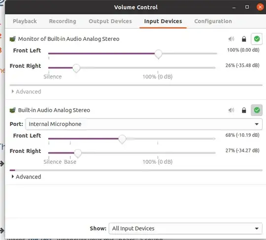

I have some problems with my sound card which is solved by unbalancing the left and right mic level via pulse audio input level option as you can see:
Volume control

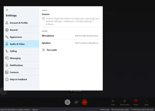

But it will be adjusted automatically after some seconds and I don't know why this happen, maybe Skype is doing that, but I don't find the allows Skype to automatically control... instruction in my Skype as you can see:
Edit 1. In Skype's Options --> Sound uncheck the tick that allows Skype to automatically control the volume settings.
Skyoe settings

I have found, it would stay on the manually adjusted right and left mic level as shown below, by changing the all input device levels manually (not only one of them!):
volume control
But I don't know it would not be changed by itself during the webinar and... I would test it tomorrow and if I don't forget, I would write here about its connection setting.
