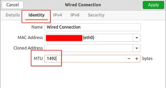

ip a 1: lo: <LOOPBACK,UP,LOWER_UP> mtu 65536 qdisc noqueue state UNKNOWN group default qlen 1000 link/loopback 00:00:00:00:00:00 brd 00:00:00:00:00:00 inet 127.0.0.1/8 scope host lo valid_lft forever preferred_lft forever inet6 ::1/128 scope host valid_lft forever preferred_lft forever 2: enp2s0: <BROADCAST,MULTICAST,UP,LOWER_UP> mtu 1500 qdisc fq_codel state UP group default qlen 1000 link/ether d8:cb:8a:e8:e9:99 brd ff:ff:ff:ff:ff:ff inet 192.168.178.23/24 brd 192.168.178.255 scope global dynamic noprefixroute enp2s0 valid_lft 862605sec preferred_lft 862605sec
@tracepath
When I execute it I'll get 1500 in the beginning, but the second time I get 1492, which seems to be the better value. Maybe this explains why I get issues sometimes when I first try to load a page. Where can I set MTU to 1492 permanently?

more info added on 28th september ....
link to image file with MTU settings: https://i.sstatic.net/LKkGK.png

Your problem is probably with the MTU setting for your DSL connection.
There's a MTU setting in Ubuntu's network configuration, and a WAN MTU setting in your router.
For DSL, a common MTU setting is 1492. Just go ahead and try this value first and see if your web sites are now accessible.
To determine the correct setting, start with all MTU settings = 1500 and VPN = off. (VPN requires different testing).
In the terminal:
ping [-c count] [-M do] [-s packet_size] [host]
The options used are:
  • c count: number of times to ping
  • M hint: Select Path MTU Discovery strategy. may be either do (prohibit fragmentation, even local one), want (do PMTU discovery, fragment locally when packet size is large), or dont (do not set DF flag).
  • s packet_size: Specifies the number of data bytes to be sent.
You should always start at 1472 and work your way down by 10 each time. Once you get a reply, go up by 1 until you get a fragmented packet. Take that value (last good value) and add 28 to the value to account for the various TCP/IP headers. Eg. let's say that 1452 was the proper packet size (where you first got an ICMP reply to your ping). The actual MTU size would be 1480, which is the optimum for the network we're working with.
    ping -c 4 -M do -s 1472 8.8.8.8 # this will probably show fragmentation
    ping -c 4 -M do -s 1462 8.8.8.8 # may show fragmentation
    ping -c 4 -M do -s 1452 8.8.8.8 # no fragmentation?
    ping -c 4 -M do -s 1453 8.8.8.8 # still no fragmentation?
reference: How to determine the proper MTU size with ICMP pings
heynnema
