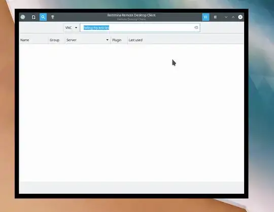

After doing the above, I noticed my remmina window wasn't rendering correctly. I'm not sure if this is an issue with KDE or remmina, but I'm adding it here nonetheless. Clicks on the black border seem to go to the desktop behind it, not to remmina. Showing the weird black border around Remmina
