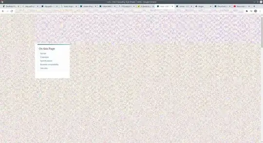

Each time I go into suspend mode and then resume, Chrome browser displays the current tab as full of sand of colors, something like dithering in image processing.
screenshot
Other tabs display glitches too.
The current solution is to close and reopen the browser.

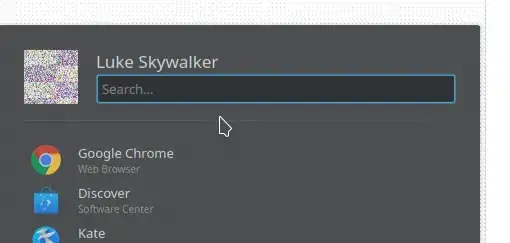

The problem is more evident in Chrome, but it sometimes appears in vscode in small areas. There, hovering the mouse over the affected place or resizing the window fixes the problem. In Kubuntu the avatar of the user in the application launcher also shows dithered.
screenshot

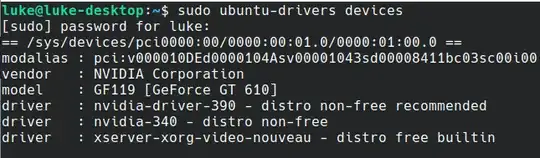

ubuntu-drivers output
Could it be a GPU problem?

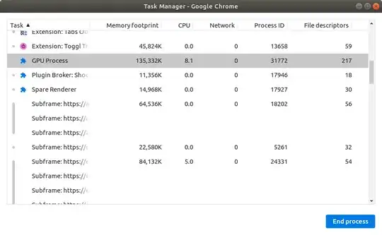

You can kill just the browser's GPU process
  • Open the Task Manager:
    • Hit Shift+Esc (as pointed out by @NYCeyes in the comments).
    • Or alternatively, go to the Chrome main menu (3 dots on the top right corner) → More ToolsTask Manager.
  • Sort by process Task name.
  • Find the process called GPU Process.
  • Click on End process.
Chrome Task Manager - GPU Process - End process
That will "clean" all the glitchy image noise. And Chrome will immediately create a new GPU process automatically.
Note: You can automatize the process, check Andrew Bruce's answer putting these steps in a script that runs automatically.

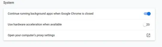

1st Solution (performance issues)
In my case a solution for the Chrome browser is disable in Settings: Use hardware acceleration when available.
chrome://settings/system
