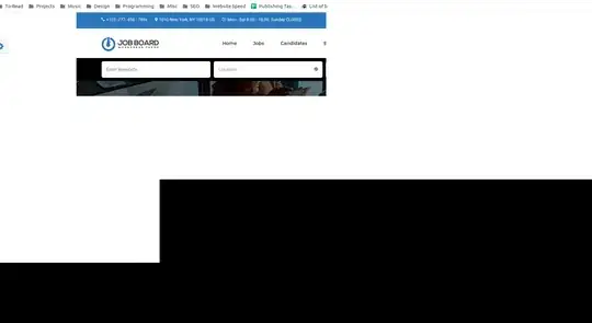

If I had chrome opened, and I put my laptop to sleep. When I log back in, google chrome's display gets distorted and becomes black (seen in screenshot below).
All tabs becomes black and when I move the mouse over the black spaces, the black squares move.
This problem started happening when I upgraded from 18.04 to 20.04
