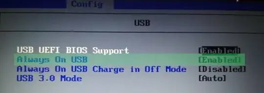

As I found out that putting the system in sleep mode acts like unplugging and re-plugging the drive, I got suspected that there might be some issues with the USB ports and their power source.
I went through the BIOS and set "Always On USB" to "Enable"; It seems that setting this parameter to Enable has fixed the issue.
