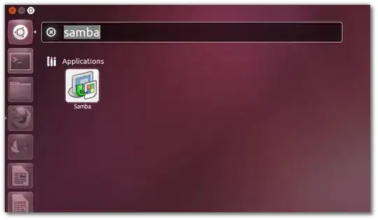

Open samba configuration tool.

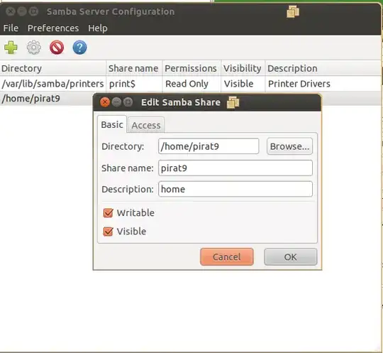

Add the folder you want to share and setup the permissions
Create a samba user
sudo smbpasswd -a  jones
New SMB password
retype New SMB Password
You can chose any directory you want to share by right click on the folder directory and open the share options
Now at this point if your ubuntu server has ip: 192.168.1.10 you can access to your folder with a Linux Machine typing on Nautilus address bar:
smb://192.168.1.10/pirat9
or on a windows machine with:
\\192.168.1.10\pirat9
