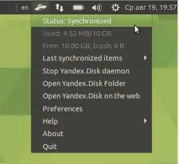

Finally we can launch the Yandex.Disk Indicator from ApplicationsInternet menu and follow steps of the wizard. Sometimes wizard need to run twice.
The wizard will create ~/Yandex.Disk folder (default) and will launch indicator in the tray to inform user about updates and to communicate with daemon:
