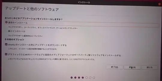

When I installed Ubuntu 20.04, I checked
  • normal installation
  • Download updates while installing Ubuntu
  • installing third-party software for graphics and wifi hardware...
Picture : install Ubuntu Checked settings

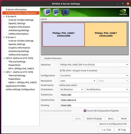

So I set up "NVIDIA X SERVER SETTINGS" as follows.
Picture : X SERVER SETTINGS for first monitor
Picture : X SERVER SETTINGS for second monitor

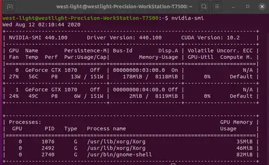

This is my nvidia-smi info.
Wed Aug 12 17:24:37 2020
| NVIDIA-SMI 440.100      Driver Version: 440.100      CUDA Version: 10.2     |
| GPU  Name        Persistence-M| Bus-Id        Disp.A | Volatile Uncorr. ECC |
| Fan  Temp  Perf  Pwr:Usage/Cap|         Memory-Usage | GPU-Util  Compute M. |
|   0  GeForce GTX 1070    Off  | 00000000:03:00.0  On |                  N/A |
| 24%   56C    P0    39W / 151W |    462MiB /  8118MiB |      1%      Default |
|   1  GeForce GTX 1070    Off  | 00000000:04:00.0  On |                  N/A |
| 24%   37C    P8     7W / 151W |     54MiB /  8119MiB |     11%      Default |
+-----------------------------------------------------------------------------+ | Processes: GPU Memory | | GPU PID Type Process name Usage | |=============================================================================| | 0 1103 G /usr/lib/xorg/Xorg 35MiB | | 0 1707 G /usr/lib/xorg/Xorg 206MiB | | 0 1917 G /usr/bin/gnome-shell 121MiB | | 0 2830 G /usr/bin/nvidia-settings 3MiB | | 0 3201 G /usr/lib/firefox/firefox 2MiB | | 0 3278 G /usr/lib/firefox/firefox 2MiB | | 0 3460 G /usr/lib/firefox/firefox 2MiB | | 0 5499 G ...094687058528,131072 --disable-features= 36MiB | | 0 5731 G /usr/lib/firefox/firefox 2MiB | | 0 5774 G /usr/lib/firefox/firefox 2MiB | | 0 5830 G /usr/lib/firefox/firefox 2MiB | | 0 7114 G /usr/lib/firefox/firefox 2MiB | | 1 1103 G /usr/lib/xorg/Xorg 14MiB | | 1 1707 G /usr/lib/xorg/Xorg 15MiB | | 1 2830 G /usr/bin/nvidia-settings 0MiB | +-----------------------------------------------------------------------------+
