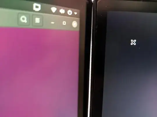

After rebooting, I still get GNOME on the one monitor. The other monitor, however, is a black screen with just the default X cursor (the glow on the right is just reflections on the monitor):
I also noticed two gdm3 sessions in htop, one running:
/usr/lib/xorg/Xorg vt2 -displayfd 3 -auth /run/user/1000/gdm/Xauthority -background none -noreset -keeptty -verbose 3
The other running the same command line but with vt1 instead of vt2. Killing the vt2 one killed my GNOME session. Killing the other one, however, seemed to do nothing. I can even still see a cursor on the second monitor.

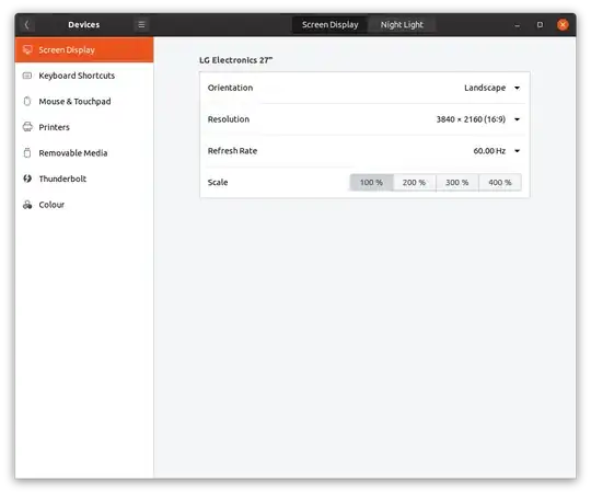

Afaict from Settings | Devices | Screen Display, only one monitor is present:

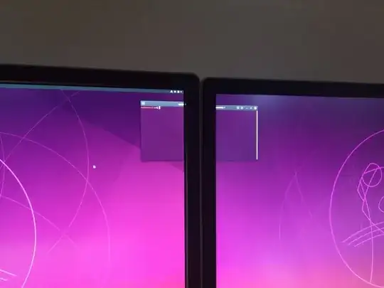

Your xorg.conf shows the following setup. You have configured two screens one is most probably localhost:0.0 and the other is localhost:0.1 (or :0.0 and :0.1 shorter). It is also possible :1.0 and :1.1 or :2.0 and :2.1, but since you have Xorg.0.log it is :0.0 and :0.1. Just for info. If you run more Xorg instances, you get higher display numbers. It is handy for multiseat setups (https://www.x.org/wiki/Development/Documentation/Multiseat/), but you don't need this.
I see you noticed two Xorg programs running. One on vt1 and another on vt2. You can switch between them with AltCtrlF1 and AltCtrlF2. See Duplicate xorg session created on Ubuntu 18.04 with Nvidia Drivers for more info.
Try to run these commands from command prompt:
DISPLAY=:0.0 xclock &
DISPLAY=:0.1 xclock &
They should open two xclocks each on one screen. The xclock on second screen cannot be moved because there is no window manager there. The "X" cursor on second screen indicates that Xorg runs properly there. You just don't have window manager on that screen. The problem you have is that GNome obviously cannot handle two screens (:0.0, and :0.1). It can be seen in the xorg.conf, that each screen is running on its own graphics adapter (BusID "PCI:10:0:0", BusID "PCI:04:0:0").
You could run another window manager on second screen, but I think you don't want to do that although either. It comes handy for some configurations. You cannot move windows from on screen to another in that case.
I think the solution in your case would be to use Xinerama (https://en.wikipedia.org/wiki/Xinerama, https://help.ubuntu.com/community/XineramaHowTo), which you have disabled in your xorg.conf. From your xorg.conf it can be seen that Xinerama is disabled (Option "Xinerama" "0").
You can try just to enable Xinerama in xorg.conf (Option "Xinerama" "1"), or generate another xorg.conf with nvidia-settings this time with Xinerama enabled.

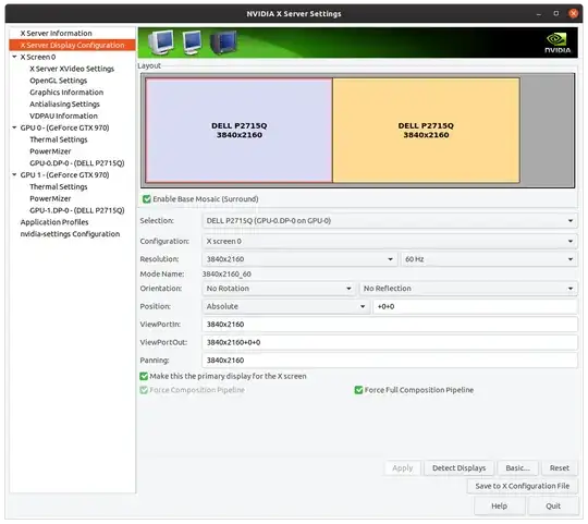

I solved my problem using nvidia-settings to force:
  • ONLY one GPU
  • attach both screens to the same XServer
screen-1
screen-2
dual-screen-3
My /etc/X11/xorg.conf looks like:
# nvidia-settings: X configuration file generated by nvidia-settings
# nvidia-settings:  version 435.21
Section "ServerLayout"
    Identifier     "Layout0"
    Screen      0  "Screen0" 0 0
    InputDevice    "Keyboard0" "CoreKeyboard"
    InputDevice    "Mouse0" "CorePointer"
EndSection
Section "Files"
EndSection
Section "InputDevice"
    # generated from default
    Identifier     "Mouse0"
    Driver         "mouse"
    Option         "Protocol" "auto"
    Option         "Device" "/dev/psaux"
    Option         "Emulate3Buttons" "no"
    Option         "ZAxisMapping" "4 5"
EndSection
    Identifier     "Keyboard0"
    Driver         "kbd"
EndSection
Section "Monitor"
    # HorizSync source: edid, VertRefresh source: edid
    Identifier     "Monitor0"
    VendorName     "Unknown"
    ModelName      "DELL P2715Q"
    HorizSync       31.0 - 140.0
    VertRefresh     29.0 - 75.0
    Option         "DPMS"
EndSection
Section "Device"
    Identifier     "Device0"
    Driver         "nvidia"
    VendorName     "NVIDIA Corporation"
    BoardName      "GeForce GTX 970"
    BusID          "PCI:2:0:0"
EndSection
Section "Screen"
    Identifier     "Screen0"
    Device         "Device0"
    Monitor        "Monitor0"
    DefaultDepth    24
    Option         "Stereo" "0"
    Option         "nvidiaXineramaInfoOrder" "DFP-2"
    Option         "metamodes" "GPU-7b73f4b2-5211-0f20-32fb-4e29bfc82a31.DP-0: 3840x2160_60 +0+0 {ForceCompositionPipeline=On, ForceFullCompositionPipeline=On}, GPU-48e16c73-84d2-6b66-9625-b44b1ab1642d.DP-0: nvidia-auto-select +3840+0"
    Option         "MultiGPU" "Off"
    Option         "SLI" "off"
    Option         "BaseMosaic" "on"
    SubSection     "Display"
        Depth       24
    EndSubSection
EndSection
I hope this helps you!
