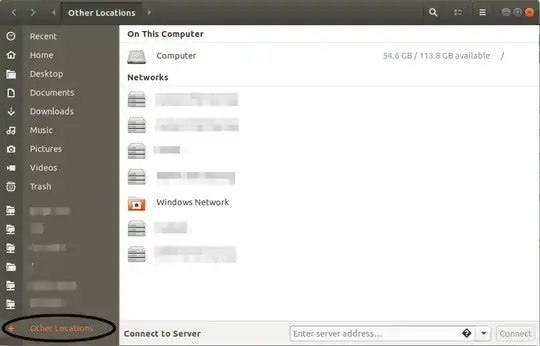

Use the SAMBA client in Ubuntu to access the shared folders in Windows laptop. To do this, open the Files app in Ubuntu and select the Other locations on the left margin at the bottom:
Then click on the Windows Network. There you should be able to see the name of the Windows laptop. Click on that, and you should be able to see the shared folder, you shared in Step 1."
Step 3
Copy all the shared folders into Ubuntu "Home". You may want to copy the Documents, Music, Pictures, etc. in the corresponding Ubuntu folders by dragging the contents of those Windows folders into the corresponding Ubuntu folders as seen the left margin of the picture above.
