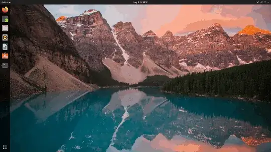

Below GIF shows the result. However, when gnome-shell refreshes/re-login/reboot etc. will affect the persistence.
screenshot
