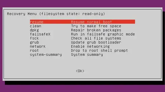

GRUB & recovery mode
I entered into GRUB (2.02) by pressing the right SHIFT key at boot time.
I am using Linux 4.15.0.-112-generic. There are also 4.15.0.-111-generic, 4.2.0.-42-generic, 4.2.0.-41-generic, 3.13.0.-64-generic, ... available.
When I select 4.15.0.-112-generic (recovery mode) then the boot process does not get further. But I get to the Recovery menu: filesystem state: read-only).
Recovery menu
When I choose Resume normal boot I get to the usual UI login.
