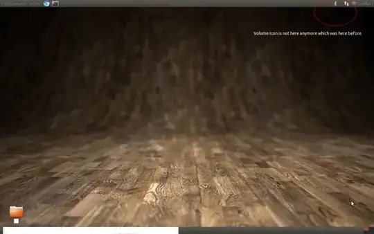

I updgraded my ubuntu to 12.04 LTS and then installed gnome classic since I do not like unity. But then the volume icon at the up-right corner has disappeared. How can I get it back to that place. Thanks for any help.

from your screenshot, it looks like you have removed the indicator applet complete applet

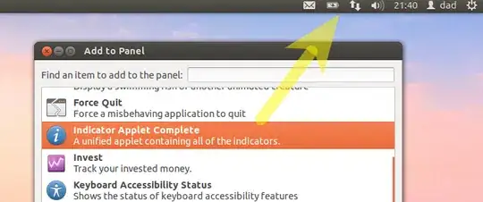

Alt+Win+ right click the panel to add the applet. You can similarly remove the other gnome-applets.
If the applet doesnt appear in your list, install the applet from software-center:
Install via the software center
or via the command line:
sudo apt-get install indicator-applet-complete

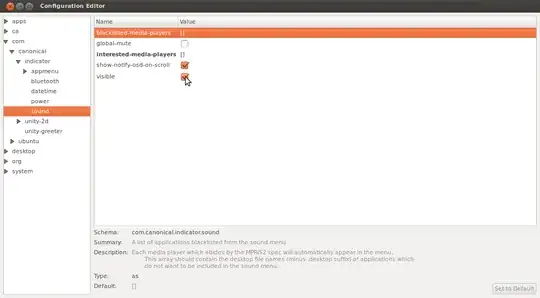

sudo apt-get install dconf-editor
than refer to the following figure to make visible the applets that you need. enter image description here

Alt+Win+ right click the panel to add an applet.
There are two kinds of indicator applets. I dont know the exact translation, but there is a standard and a full version. Try the full version.
