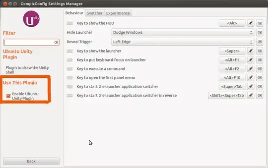

Just open CCSM, scroll down to Desktop, click on Ubuntu Unity Plugin, make sure Enable Unity Plugin is checked in the box on the left side panel of the CCSM window.
That fixed mine. No reboot required.
