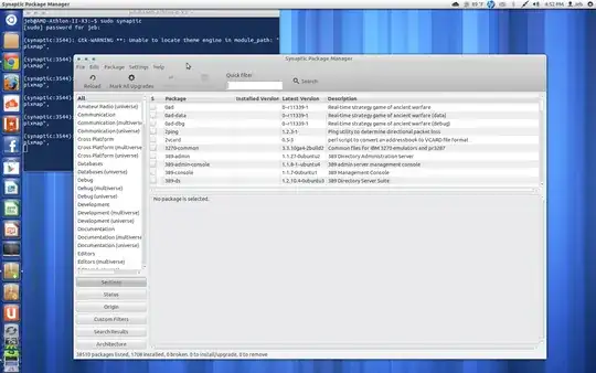

The fix is quite simple, actually. Please install Synaptic Package Manager in the Ubuntu Software Center, first. After installed, you will need to open it with root privilages:
sudo synaptic
Search for Oracle-java7-installer, right click on it, and completely remove it. Apply the changes, remove the PPA, and your error messages will be gone.enter image description here
Jebeld17
  • 1,902
Synaptic Package Manager is very useful in removing a file which has a dependency issue, and particularly when sudo apt-get install -f does not work.
