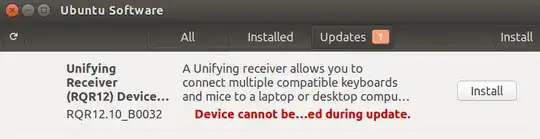

  • GUI Alternative: In case you don't want to do the update through the terminal (previous steps), you can try the Software Center, Updates tab (image below):
Software Center

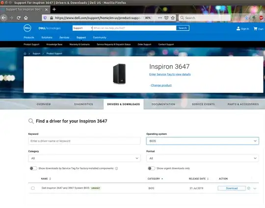

4. Find the latest bios firmware version available for your computer from Dell
  • Go to the Dell Support Website and find your computer by informing its model, service tag or express service tag.
  • Click on the Drivers & Downloads tab.
  • On the Operating System drop-down button, choose BIOS. The system will show the latest version available.
  • If the version installed on your computer is out-of-date, download the file. It's a Windows executable file (.exe).
Dell Webpage Support

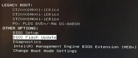

5. Update using Flash Boot (available for computers from 2015 onwards)
This section is suitable if your bios offers the option BIOS Flash Update in Boot Menu (image below).
Bios Flash Update

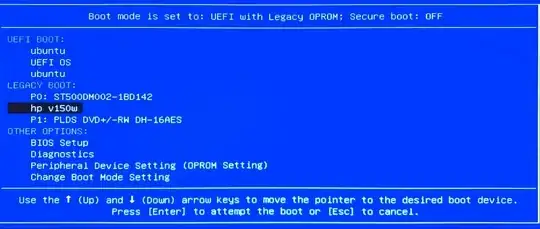

  • As soon as the Dell logo is displayed, type F12 to be redirected to the Boot Menu.
  • Choose to boot from the USB drive (image below). If this option is not available on the menu, you might need to switch the bios from UEFI mode to Legacy mode.
Boot Menu

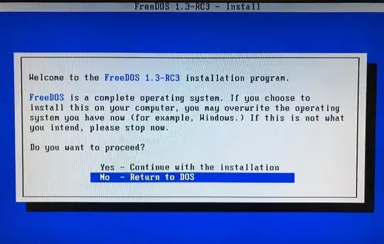

  • At the beginning of the FreeDOS boot process, you will be asked to proceed with the installation, or cancel and leave to the DOS terminal. Choose "No - Return to DOS" (image below), otherwise Ubuntu will be overwritten with FreeDOS.
FreeDOS
