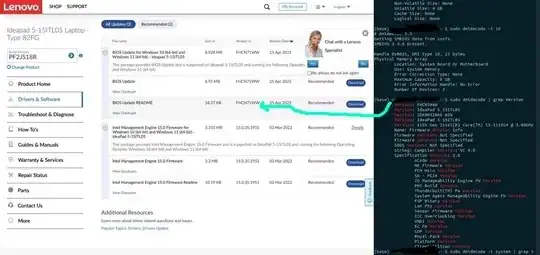

How do I update my BIOS from an Ubuntu for my machine (Ideapad 5-15ITL05 Laptop - Type 82FG)? checking the manufacture website:
https://pcsupport.lenovo.com/il/en/products/laptops-and-netbooks/5-series/ideapad-5-15itl05/82fg/82fg009riv/pf2js18r
There is a new bios version. They only have a .exe file.
I have wine, and am afraid running an exe from wine that updates a bios, if that makes any sense. I contacted the support so they might send me a file i can slap on a usb and boot, but Lenovos response was "We do not support Linux OS. please contact Linux for support." (get it?)
Updating bios
Kar19
  • 459
  • 28
You should be able to Flash BIOS with UEFI Tool on a (FAT32) usb stick as in : https://support.lenovo.com/us/en/solutions/ht118103-flash-bios-with-uefi-tool-ideacentre-stick-300 (I didn't know it 2" ago, so that's why I'm writing it down somewhere ..)
