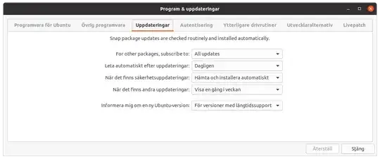

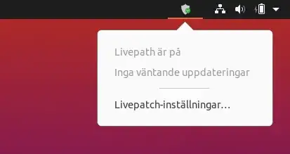

The following screenshot shows what it looks like for me (when active),
When you click on 'Livepatch settings...' you can select what kind of updates you want, as illustrated in the next screenshot,
Sorry for the mixture with some non-English text, but this is in my installed system. 'Program & uppdateringar' means 'Software & Updates'.

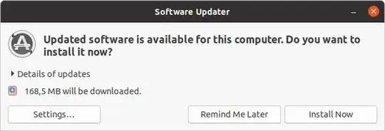

In this case a window pops up soon after you boot and log in,

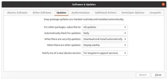

and also from this window you access 'Software & Updates',
This time I can show things in English, which makes it easier to recognize.
