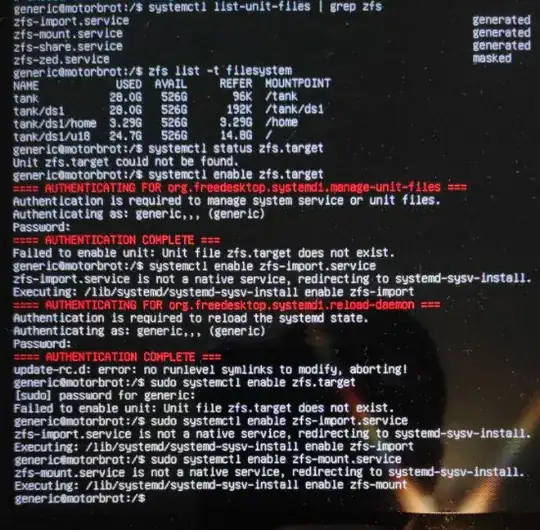

Solution
Following How can I make ZFS datasets mount automatically on boot I am informed that zfs.target does not exist and that both zfs-import.service and zfs-mount.service are "not native services, redirecting to systemd-sysv-install". enter image description here
After running these commands, the output of systemctl list-unit-files | grep zfs is still the same. I would have expected the status to change to enabled.
However, after a reboot the login works again - /tank/ds1/home is mounted correctly to /home.
Now that I am finding this question again, a year later, having the exact same problem with a new encrypted dataset, this "solution" is not helping anymore.
