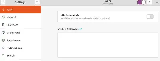

Under the System Settings,
  • There are no Visible Networks No Visible Networks
  • No Known Wi-Fi Networks.

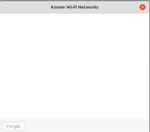

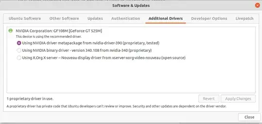

    But, under Software & Updates -> Additional Drivers section there is no driver listed for the Network wifi card.
    Snapshot on Additional Drivers menu
    Is it only because the driver is a generic driver? Can (or, not) the network card work with only a generic wifi driver? If it can, how to enable it? If not, will it work once I install the particular driver?
