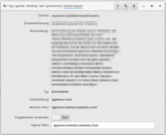

In Ubuntu Gnome 17.04 use
dconf-editor
to open the Editor and you can find it here:
Isengo
