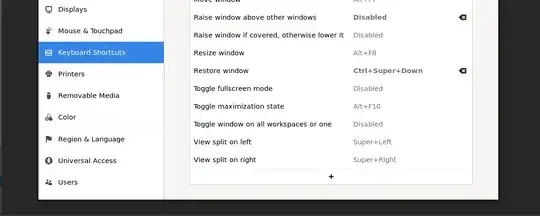

On 20.04
Change or remove the shortcut for settings->toggle maximization state

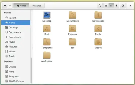

Install Elementary theme (ftom Elementary OS). This will move close button to the left corner and appear maximize in right.
You will get like this:
But if you select other themes after Elementary theme, layout don't save and will back to default in the next log in. I think, it possible to copy layput settings from Elementary theme and put it in any other.
