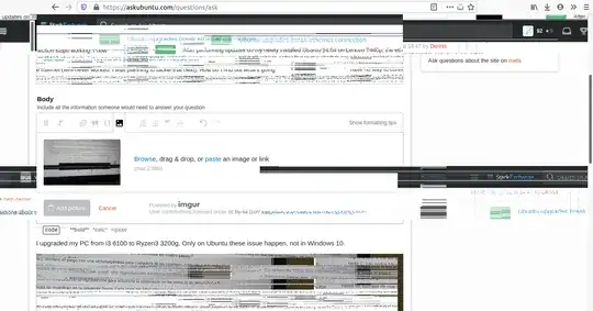

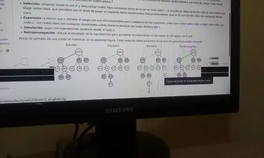

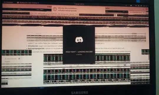

I upgraded my PC from i3 6100 to Ryzen3 3200g. Only on Ubuntu, these issue happen, not in Windows 10. On Firefox, Chromium, wine windows, Clion and other programs.
These issues appear on screenshots too:
