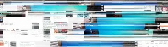

I have recently installed four computers with Linux. Each one has different monitors, refresh rates, versions, etc. The only constant in all four is the processor with the integrated graphics. Here is a screenshot that I was able to take.
Here
AMD doesn't have official drivers for Linux for this particular processor and I'm not entirely sure about where to go from here. Has anybody else had issues with this?
I have been conducting tests, and I see there is no issue at all with a fresh installation of Ubuntu 18.04.3. I still have a little more testing to do, but I reckon it will start giving me issues as soon as I update my drivers in 18.04.
It turns out I was exactly right. It seems like there are issues with the current kernel with this specific AMD processor. We just ordered a few Nvidia graphics cards because we need to run programs that require specific kernels and we can't afford to waste any more time on this issue. If anybody needs a quick fix and doesn't necessarily care about which kernel version they are using, I found that version 5.0.0-23 works without any issues.
