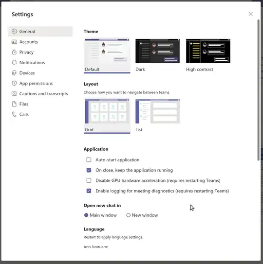

The only method I have found so far to solve the problem is configuring settings in Teams:
  • Right click the Teams icon on the system tray
  • open Settings
  • uncheck Auto-start Application
teams settings

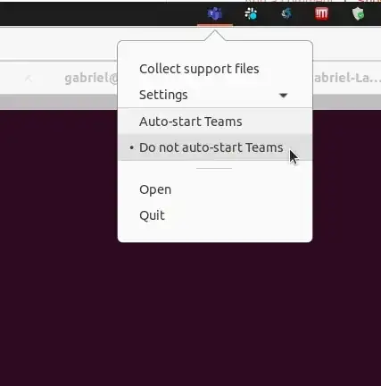

Note: In some versions, you can right click the system tray icon and disable autostart right there.

After opening teams, click on your profile picture on the top right corner and then settings. Under General uncheck "Auto-start application".
Open teams->click profile image->settings->uncheck Auto-start application

Following the main answer by @Archisman Panigrahi, here's what the new interface looks like:
Left-click the blue Teams icon in the top-right of Ubuntu --> click "Settings" --> click "Do not auto-start Teams."
Reboot and you'll see it did NOT automatically start up this time! THANK YOU.
