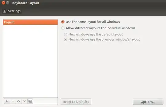

I have installed Ubuntu as virtual machine by VMware Fusion. The keyboard setting of Ubuntu is as follows:

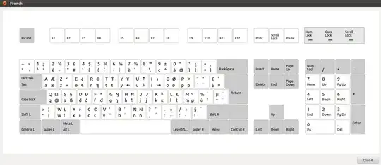

And the preview is not exactly as Apple Wireless Keyboard - French:

I'm setting on a macBook pro - same keyboard pretty much!
I've switched my layout to My Language [Macintosh] - now i can make:
[ ]RightAlt8 & RightAlt9
{ }RightAlt7 & RightAlt0
\RightAlt+
So it's pretty much the best solution i found, as it makes it manageable by doing it as windows normally do, but it's sorta off from the normal mac way.

Did you gave a try to Keyboard-configuration?
In my case (Ubuntu 12.04 server on MacBookPro 10.9 within VirtualBox 4.3.8 (ok, not Fusion, but similar conditions right?), here is what I did:
sudo apt-get install keyboard-configuration sudo dpkg-reconfigure keyboard-configuration
keyboard-configuration choices for MackBookPro French keyboard:
1. MacBook / MacBookPro (Intl)
2. French
3. French (yes, again)
4. Right Alt (AltGr)
5. No Compose Key
Seems keyboard settings works fine and are keep after reboot.
I may have to tests some other parameter value for 2. 3.and 5.
It took me 5 minutes to find out the right parameters for you: hope it will be that fast for you
