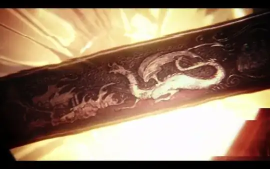

I have that problem which seemingly afflicts many using the proprietary Nvidia driver:
Video tearing: fine horizontal lines (usually near the top of my display) when there is a lot of panning or action in the video.
(Note: switching back to the default nouveau driver is not an option, as its seemingly nonexistent power-management drains my battery several times faster)
I've tried Totem, Parole, and VLC, and tearing occurs with all of them. The best result has been to use X11 output in VLC, but there is still tearing with relatively moderate action.
Hardware: MacBook Air 3,2 -- which has an Nvidia GeForce 320M.

Example of observed tearing:: video tearing

The attached screenshot definitely shows tearing! If the player is otherwise keeping up with decoding the video (ie, no stuttering slow downs, just the tearing), then it probably doesn't matter if it's the CPU or GPU doing the decoding. VLC has an option on the Video settings page in Preferences to turn on and off "Accelerated video output"; if it's on, it ought to be using the GPU to decode. If you toggle that setting in VLC and run top in a terminal whilst playing the video, you should see a difference in CPU usage between the two settings. You could also try turning off any de-interlacing in VLC to see if that makes a difference.
