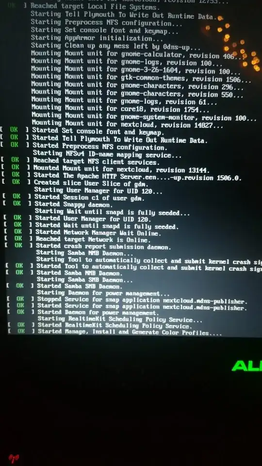

When my laptop goes to suspend it gets stuck indefinitely and never actually suspends.
The last line I get whne it gets stuck is "Starting Manage, Install and Generate Color Profiles".
This happens both when I choose to suspend from the menu and when I just close the lid and let it suspend by itself.
Here is a picture of my screen when it gets stuck:
