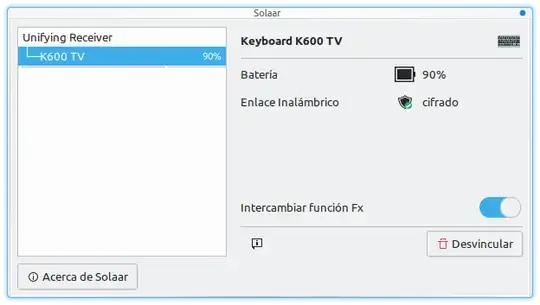

You can use solaar, which has a version in Ubuntu's universal repo.
sudo apt install solaar
Then, you run solaar, it has a nice GUI with instructions, once you connect a Logitech keyboard, it will show you a switch for de Fn key behavior.
