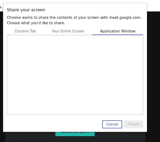

Now using the version 20.04 when I try to share just one window it doesn't work anywhere: I tried Google Meet, Skype, Zoom, Hangouts, Discord and Microsoft Teams. That happens both on the browser (tried Chrome, Chrome Beta, Chromium and Firefox) and on the apps when available. Sharing the entire screen works.
Google meet when I try to share applications

Update #1:
We've isolated the problem to something in your own account.
I'll outline a procedure to try and isolate common trouble areas.
There are three folders that can typically cause problems:
  • ~/.cache
  • ~/.local
  • ~/.config
The process is the same to eliminate ONE FOLDER AT A TIME. I'll use ~/.cache as the example.
Note: It's normal for some system/application settings to change during this procedure. Screen resolution, etc. That's normal. Don't panic.
  • rename ~/.cache to ~/.cache.HOLD
  • a fresh new ~/.cache folder will get recreated at log in
  • log out of your account
  • log back into your account
  • try to recreate the sharing problem
  • if the problem still exists, then ~/.cache is not the problem, then do:
  • MOVE the fresh new ~/.cache folder out to the Desktop, we'll trash it later
  • rename ~/.cache.HOLD to ~/.cache
  • IMMEDIATELY log out
  • log back in
  • if the problem is fixed, then the problem exists in the ~/.cache.HOLD folder, then do:
  • MOVE, NOT COPY, everything from ~/.cache.HOLD folder back into the fresh new ~/.cache folder, SKIPPING any existing files
  • anything left over in the ~/.cache.HOLD folder is potentially bad
  • done
