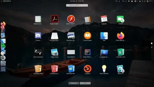

I have recently upgraded Ubuntu from 19.10 to 20.04. Since updating dash to dock behaves abnormally. It works normal initially, later when i lock the screen then the problem starts.
Look at the left
When I logout and log in again it works fine until I lock the screen.

Assuming that you've got the most current version of DtD, you'll need to do either of the following...
Disable Ubuntu Dock via the Extensions Manager or via https://extensions.gnome.org/local/
Or
sudo mv /usr/share/gnome-shell/extensions/ubuntu-dock@ubuntu.com ~/Desktop
Restart gnome-shell...
ALT+F2, in the box type r, then ENTER
