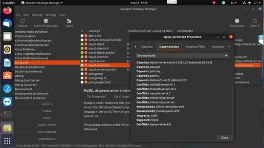

I have removed Libmysqlclient21 in synaptic since it appeared as broken, attempted to uninstall MySQL successfully on synaptic and reinstall it synaptic UNsuccessfully, apparently there is a running MySQL process that I can't find, which prevents the installation of mysql-server-8.0 (mysql-client, client-8.0, client-core-8.0, server and server-core-8.0 reinstall just fine). Following you will find the ubuntu terminal capture cleaning up https://pastebin.ubuntu.com/p/pJCxYm5K2w/ , as well as synaptic screen capture displaying a conflict with "itself", ps aux reports no instance of mysql running,
mysql server conflict

Just in case someone gets in the same situation, this is something to consider. I don't understand what happened, I was accessing the ubuntu machine remotely through a user account with full administrative privileges, but it was not the account created at the time of installing ubuntu, now I have finally accessed the computer directly and login in with the original account and much to my surprise, when I attempted to uninstall all of MySQL trough synaptic, I didn't get warnings or errors at all, just to play it on the safe side I run the following commands
# sudo apt-get remove --purge mysql-server mysql-client mysql-common -y
# sudo apt-get autoremove -y
# rm -rf /etc/mysql
# sudo find / -iname 'mysql*' -exec rm -rf {} \;
# apt --fix-broken install
no errors or warnings at all, so I launched synaptic and reinstalled mysql-server (synaptic took care of the dependencies) and the installation finished correctly. This makes no sense to me since a user account with full administrative privileges should have full access, but there yo have it, MySQL is installed and running.
