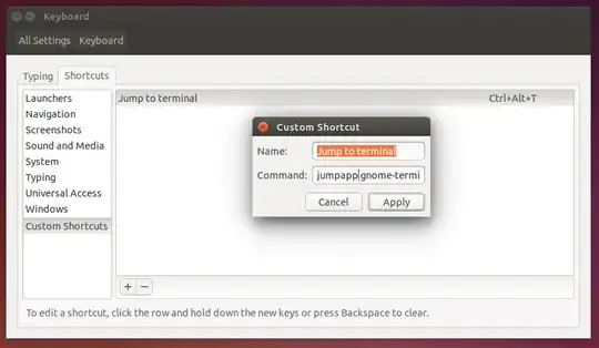

I've written a small program called jumpapp for exactly this purpose. It lets you create one keyboard shortcut to opens a new terminal the first time you press it, and to switch to the already open window any time you press it after that. As a bonus, if you have multiple terminal windows open, repeatedly pressing the shortcut will cycle through all the terminal windows.
It's easy to install from source, or you can install it from my PPA:
sudo add-apt-repository ppa:mkropat/ppa
sudo apt-get update
sudo apt-get install jumpapp
