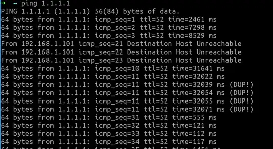

Currently, I installed Lubuntu 20.04 on my Thinkpad Lenovo laptop. sometimes the networks became very slow, I command a ping 1.1.1.1 or ping 4.2.2.4 but it falls in a very deep delay. parallelly, I connect to my modem by my Android phone and the result of ping is so good, something around 100 till 170 ms, this is my last ping:
When I turn off and then turn on the WiFi, it became ok but after few seconds it falls into trouble again and I don't know why. sometimes like now, I don't have any problems. but sometimes it became very laggy and slow.

Any Idea how to fix this?
AmerllicA
  • 559
I had same issue on my dell xps with Intel centrino 1030N wifi adapter.
I've posted the solution today, try if this works for you. Wifi is slow and unstable on ubuntu 20.04 dual boot (DELL XPS-L502X) Please help!
