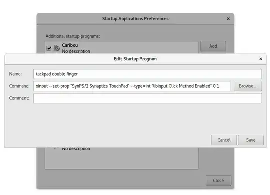

For me I lost two fingered right click after installing gnome. I tried several of these answers and this is what finally worked:
Try this:
xinput --set-prop "SynPS/2 Synaptics TouchPad" --type=int "libinput Click Method Enabled" 0 1
If it works, make it persist across reboots by adding it as a startup script. Search for Startup Application Preferences. Add a new Startup Program, and in command, paste the line from above.
Note: I previously tried adding it to /etc/X11/Xsession.d/ at first but that didn't work for me (gnome, ubuntu 16.10).
