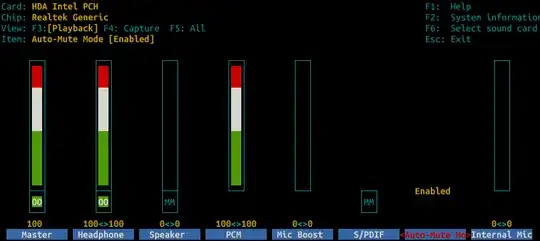

Since it's the one of the top google results related to "Ubuntu update sound noise" searches, I'll add my own answer.
After update to 21.10 (if memory serves), bit later today - to 22.04 - my laptop's headphone output was buzzing like hell, with speakers, with headphones etc.
so, alsamixer, setting auto-mute to "enabled" et voilaenter image description here
I don't know what is auto-mute, or why it affects sound in such a harsh manner, but that worked. Maybe I should find out related config options. Didn't reboot yet
