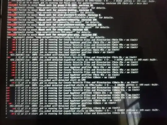

A mostly clean install of Ubuntu 20.04 occasionally boots quickly and flawlessly, but almost always hangs during boot. Sometimes it will boot 1 out of 3 times, other times I reboot 10+ times, spending 30 minutes or more just watching the boot hang, then eventually holding down the power button to force shutdown and try to boot again.
The issues usually (but not always) start just after the line [OK] started load/save RF kill switch status . That line is followed by a series of [ ***] A start job is running for... followed by all kinds of things, including installed software or /dev/disk/by-uuid pointing to both the EFI partition and the /home partition.
These run for awhile, sometimes changing to [FAILED], [DEPEND], or [TIME] and some [OK]s afterwards as well. Then there are blocks that end in rcu_sched self-detected stall on CPU... lines.  Basically, once I see those red [  *** ] A start job... things happening, it doesn't ever finish booting after that. I've sometimes let it try for 15 minutes or more.
Boot messages

The problem relates to EFI.
Here is an incomplete solution, but enough that I can debug further. I can get it to boot by blacklist EFI modules and disabling ACPI. That is, I need this:
module_blacklist=efi_rts_wq,efi_call_rts acpi=off
I found these hints at CPU soft lockup on Samsung Notebook 9 Pro | Reddit.
