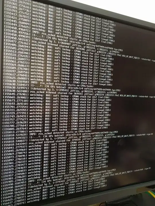

In the system log (/var/log/messages or journalctl) a lot of the
following messages is printed.
May 25 07:23:59 XXXXXXX kernel: [13445315.881356] BUG: soft lockup - CPU#16 stuck for 23s! [yyyyyyy:81602]
followed by various stack traces. This document tries to explain what
the soft lockup messages mean.
The error message itself doesn't tell you what is causing the problem.
Cause
A 'soft lockup' is defined as a bug that causes the kernel to loop in
kernel mode for more than 20 seconds, without giving other tasks a
chance to run. The watchdog daemon will send an non maskable interrupt
(NMI) to all CPUs in the system who in turn print the stack traces of
their currently running tasks.
