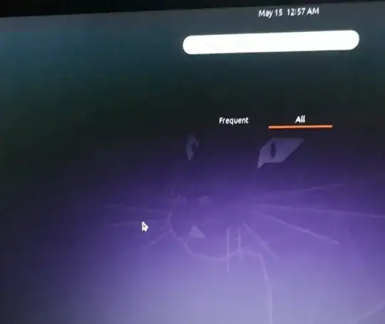

After upgrading to Ubuntu 20.04, the Applications screen freezes when I open and close the folder.

This problem was reported on Launchpad as Bug #1872268 "Gnome Shell completely freezes in Ubuntu 20.04 when clicking outside of app icon folders (when ubuntu-dock is loaded)".
In comment #25, Rson explained a temporary solution
I have this same problem. I made a video with the problem and the solution here:
https://www.youtube.com/watch?v=J3N9lnGMj-8
The bug is caused by the Ubuntu Dock extension. Changing the extension for the dock to not occupy the entire height of the screen solved the problem.
What I did to resolve it was:
  1. Install dconf
    sudo apt install dconf-editor
  2. Go to /org/gnome/shell/extensions/dash-to-dock/extend-height
  3. Deselect the "Use default value". And set "Custom value" to "False".
