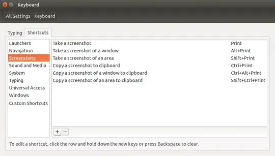

I solved the problem by going to PreferencesKeyboard Shortcuts and selecting DesktopTake a screenshot.
Keyboard Shortcuts
The setting there showed (seemingly correct) Print. However, I removed it by clicking the entry and then hitting backspace, changings it to Disabled. After that my cursor up key worked again.
