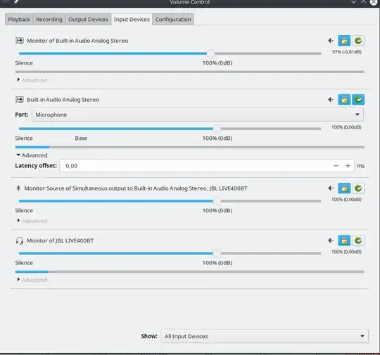

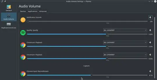

The JBL Live 400bt headphones are connected via Bluetooth to my computer.
Audio volume advanced
I can select the JBL to play audio but it does not appear as a Microphone
Audio volume applications
I also checked pavucontrol but is displayed just as monitor.
I'm using Kubuntu
Linux gmork 4.15.0-96-generic #97-Ubuntu SMP Wed Apr 1 03:25:46 UTC 2020 x86_64 x86_64 x86_64 GNU/Linux
Distributor ID: Ubuntu Description: Ubuntu 18.04.4 LTS Release: 18.04 Codename: bionic
I have tested the headphones with my mobile phone and audio and microphone work properly.
Could you please help me with this?
