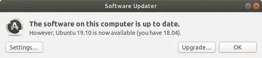

I am following the blog How to upgrade from Ubuntu 18.04 LTS to 20.04 LTS today but it seems I cannot:
hemal@hubuntu:~$ lsb_release -r
Release:    18.04
hemal@hubuntu:~$ sudo do-release-upgrade -d
Checking for a new Ubuntu release
Upgrades to the development release are only
available from the latest supported release.
Software Updater prompts me if I want to upgrade to 19.10. Do I need to do that to upgrade to 20.4?
According to the release notes for 20.04, to upgrade from 18.04 one would need to type
update-manager -c -d
This gives the message saying that the system is up-to-date and at the same time gives you the option to upgrade to 20.04.
For further details check out the release notes on Upgrading from Ubuntu 18.04 LTS or 19.10 - FocalFossa/ReleaseNotes - Ubuntu Wiki.

To directly answer your question, I would go to 19.10 then 20.04. There may be the direct path enabled now that some time has past but I am not sure.

18.04 LTS users who wish to remain on the very safe LTS path needed to wait for the first point release 20.04.1 (so that they get 20.04 with all the bug fixes that inevitably follow a new release) - which was delayed until about 6th Aug 2020. They then need to wait a further time (usu. a few days) until it is decided to make 20.04.1 available to users of 18.04. Before that time the following happens rather than getting on with the upgrade:
There is no development version of an LTS available.
To upgrade to the latest non-LTS development release
set Prompt=normal in /etc/update-manager/release-upgrades.
I think it is best then to just wait (either for a graphical prompt, or via the above command line) rather than force an upgrade by any other means if (like me) you want to be almost certain that your system remains stable.
