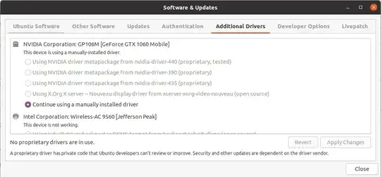

I recently installed 20.04 and I'm confused as I found this bug while changing my display drivers. While installing, I got my Nvidia drivers automatically installed, but they were buggy and had some fps drops (less than 19.10, but still uncomfortable) so I decided to choose Nouveau X.org ones. Apparently it worked, I rebooted my laptop and then I see this, please check the screenshot:
Additional Drivers Bug
It says "Using manually installed drivers" and at the end I don't know which one I'm using. Is this a bug? What can I do to clean select X.org Nouveau drivers and not Nvidia ones? Thanks in advance.
Edit: Added output of command as asked.

Also another clarification, I did ubuntu-drivers autoinstall and now everything seems ok, now I'm able to choose again and Nvidia Drivers are in use, but the output of the command is confusing me as it shows 4 kernel modules.

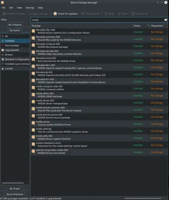

If anyone else runs into this problem you don't need to use a terminal.
Programs like Synaptic and Muon both have the ability to show all the packages you have installed. Simply type nvidia in the search and select the category of installed. Then select all the packages, right click and select purge. Now reopen the Additional Drivers gui and select the driver you would like to install.
This is muon, but synaptic looks pretty much the same. The only difference between the two mostly is one is Qt and the other is GTK. If you are on Gnome get Synaptic and if you are on Plasma get Muon. This is muon
