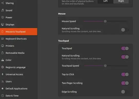

I solved my touchpad problem on Ubuntu 20.04 with this:
  1. Edit (create it if doesn't exist) the psmouse.conf file:
    sudo gedit /etc/modprobe.d/psmouse.conf
  2. Add the line:
    options psmouse synaptics_intertouch=1
  3. Then run:
    sudo modprobe -r psmouse && sudo modprobe psmouse
Disabling and enabling the touchpad in Settings somehow solves the problem.
Well, all I did was to get to the “settings” and enabled the touchpad which surprisingly was disabled. I will check for the next few days if there is an issue and I will report here.
