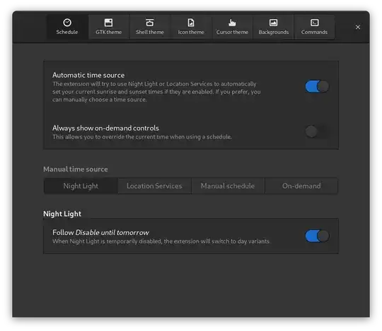

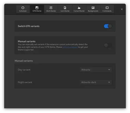

For GNOME, this shell extension exists: Night Theme Switcher
It has quite a lot of options and already works out of the box, without having to configure anything, but the configuration is straight forward as well!
Screenshot of the Schedule tab
Screenshot of the GTK theme tab

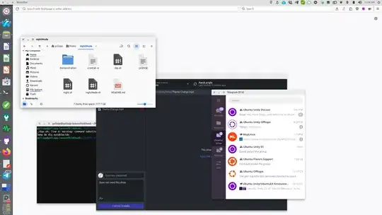

And then, in your programs configure the automatic darkmode, like in github desktop, Android Studio, firefox, etc, etc
this was my result:
Light Mode:
Light Mode
Dark Mode:
Dark Mode
