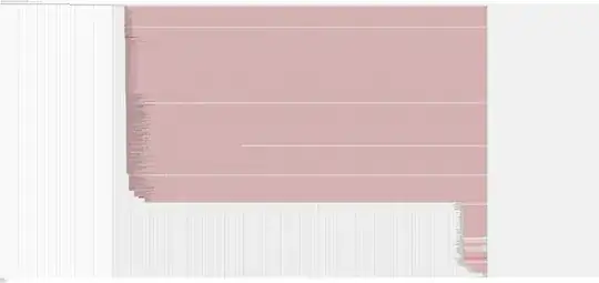

Then I saw here that there is systemd-analyze which already does sth similar by default. I created this plot: systemd-analyze plot However, I'm not exactly sure how to read that. Are these all run sequentially or in parallel? I assume in parallel. I see that some of the services (apparmor etc) are started only much later. But why? How can I see why they start so much later? I assume they depend on sth. But on what? I don't really see anything in this plot which got ready at that point. The services also have light red and a bit of dark red colors. What do these mean?

There is a big jump between systemd-tmpfiles-setup.service @1min 30.396s and systemd-journal-flush.service @493ms. But why?
