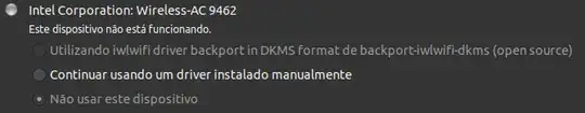

The system loads the iwlwifi-QuZ-a0-hr-b0-*.ucode firmware while the intel site lists the iwlwifi-Qu-c0-hr-b0-*.ucode as the correct firmware. Also, I get this on the additional drivers app:
Bla
Ubuntu says my wifi device is not working and the second option "Continue using manually installed driver" doesn't work.
How can I load the proper firmware?
