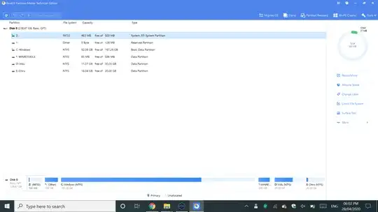

EaseUS:
EaseUS

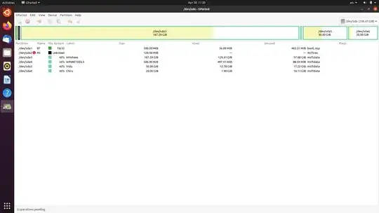

GParted:
GParted

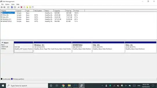

Windows Disk Management:

Create a new partition for Ubuntu.
Create new partition in windows in disk manager.
Then install the ubuntu OS on that disk
Install EasyBCD software in windows for create grub menu
or
Install Boot Repair and run in ubuntu for Create grub menu
We can install boot repair by the following command
   sudo add-apt-repository ppa:yannubuntu/boot-repair
   sudo apt-get update
  sudo apt-get install -y boot-repair && boot-repair
We can run the boot repair by the following command
 boot-repair
now you can use both os
