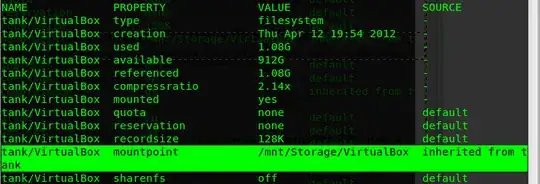

If you run the command sudo zfs get all it should list all the properties of you current zfs pools and file systems. One of those properties, if correctly set, should be mountpoint=.
Zfs will mount the pool automatically, unless you are using legacy mounts, mountpoint tells zfs where the pool should be mounted in your system by default. If not set you can do so with
sudo zfs set mountpoint=/foo_mount data
That will make zfs mount your data pool in to a designated foo_mount point of your choice.
